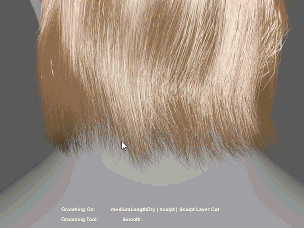

Specifies how the brush stroke applies the smoothing effect to hairs in the brush radius.
Hotkey: Pressing N Toggles between Global and Local modes.
Use Global mode to apply an overall smoothing effect to the groom.
Brush Mode: Global
Use Local mode to affect small areas of the groom.
Local is the default setting.
Brush Mode: Local
When off, the root and tip hair CVs remain locked as the brush smooths the hair curvature. Visually, the hair length does not appear to change, but hair the actual length is reduced.
