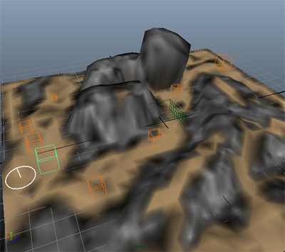

In this example, the archive objects are added to a sculpted polygon plane.
The mesh is now bound to the Description. Use the Add or Move Guides tool to place the guides on the mesh surface.
to select the
Add or Move Guides
tool.
The guides for archive primitives display on the mesh as orange cubes. You can now specify which archived geometry you want to instance on the mesh.
