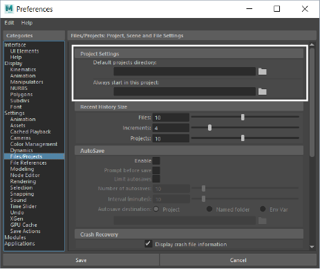

Your files will be saved to this default project unless you do either of the following:
Set a different project. To do this, see Set a Project in Maya.
Select a different default location for your project.
To select a different default location for your project
Next time you create a new project by selecting File > Project Window and clicking New, the project will be created in the location you specified.
You can also set a directory so that Maya starts with this project each time.
