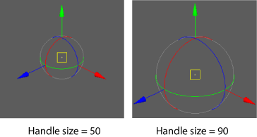

Specifies the size of the handle. The range is from 4 to 100.
