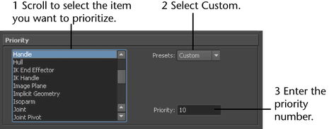

Treats all objects with the same priority. The selection order does not matter. The default is off.
