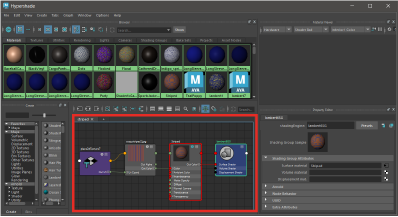

You can set the following preferences in the Hypershade window category of the Preferences window.
To return to the default factory settings, choose Edit > Restore Default Settings in this window. This resets the preferences in every category in the Preferences window.
Hypershade Work area (outlined in red)

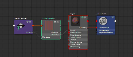

Comparison: Grid Snapping On and Off

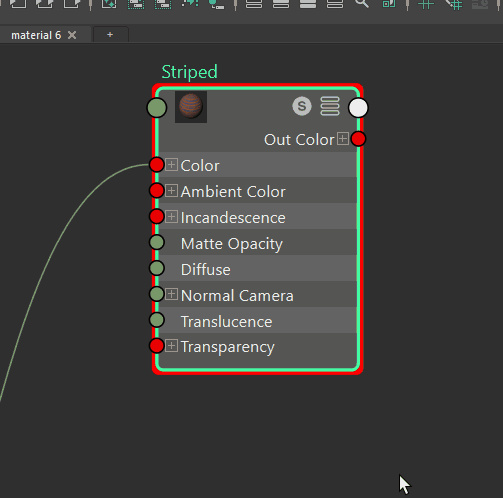

You can change the view mode for each node by clicking the
		   (simple),
 (simple),
		   (connected),
 (connected),
		   (full), or
 (full), or
		   (custom) icons on the top right corner of each node. Click 4 to view all attributes if you do not have a custom attribute view saved.
