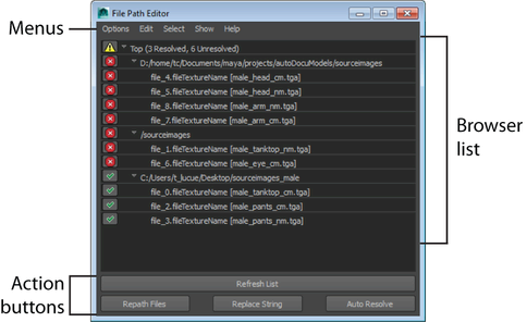

The File Path Editor lets you view a list of the files embedded in the current scene. If you move a file associated with your scene, for example, relocating it to another folder on your computer, Maya won't be able locate it and shows errors. Use the File Path Editor to relink unresolved paths quickly and easily, for example, letting you reassigning broken texture paths like a file texture editor.
The File Path Editor has the following main areas:

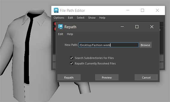

  2. Select the broken file paths and click Repath Files.
    A Repath dialog appears. Activate the Search Subdirectoriess for Files and Repath Currently Resolved Files options.

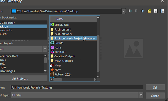

  3. Click Browse to navigate to the missing texture file location.
  4. When you have located the missing file(s), click Repath.
