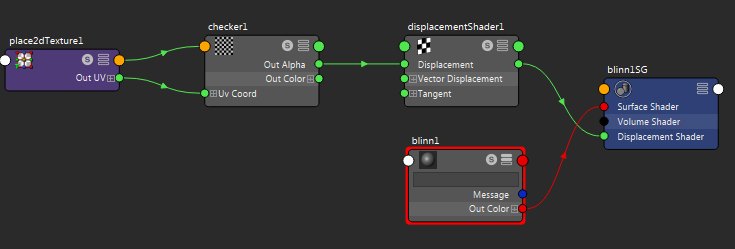

Connection between your original shading material to a displacement shader is not preserved since the shading group node has been replaced. You can create a shader override instead to preserve this connection.
A common use case is when you want to apply an ambient occlusion shader to create an ambient occlusion pass. In this example, if you were to create a material override and replace blinn1SG, you would lose the connection to your displacementShader and you would need to reconnect your displacementShader to your new shading group as a result.
Instead, you can create a shader override to replace only the blinn1 shader with an ambient occlusion shader. This way, the connection to displacementShader is preserved.
