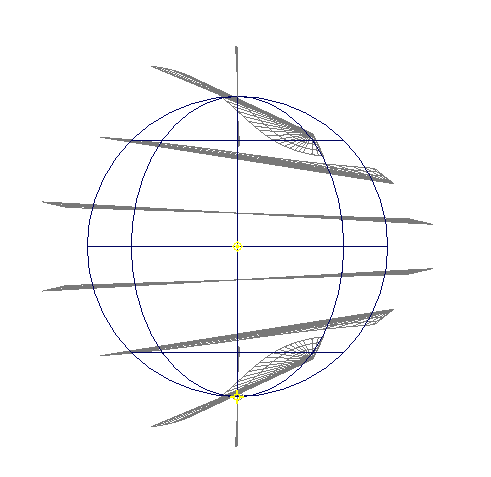

If your flow moves up or down a periodic surface, which wraps around 360 degrees, the flow manipulators may twist or pop into the surface. An example appears in the following illustration.
To avoid the twisting effect

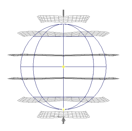

This change prevents the manipulators from popping into the surface.
For example, the sphere in the following illustration has four flows, with the Min and Max flow values adjusted according to the following table.
| Flow | Min U or V | Max U or V |
A |
0 |
.25 |
B |
.25 |
.5 |
C |
.5 |
.75 |
D |
.75 |
1 |
