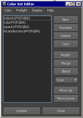

The Color Set Editor appears listing the per-vertex color set generated from your fluid object.
For example, if you want to color the fluid output mesh using the per-vertex data derived from the fluid object’s Incandescence ramp, select incandescencePV(RGBA).
If your fluid object’s data does not appear in the Color Set Editor, click Update.

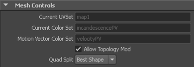

Your fluid output mesh should now display the colors defined by the selected color set. In the Mesh Control section, the Current Color Set attribute should be set the selected per-vertex data set.
