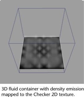

Using a Density, Heat, or Fuel emission map, you can map a 2D texture to control emitted, density, temperature, and fuel. To use an emission map, you must be using a Surface, Volume, or Curve emitter with your fluid. Emission maps are not supported for Omni emitters.
When a surface emitter is used, fluid emission is mapped using the surface object’s UV texture coordinates. When a volume emitter is used, fluid emission is mapped using a UV projection that matches the volume’s shape. For example, Cube volumes are mapped with planar projections, while Sphere volumes are mapped with spherical projections. Density, Heat, and Fuel emission values are multiplied by the texture values.
