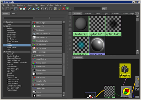

The Create Render Node window appears.
The Connection Editor appears.
This connects the Particle Sampler Info node’s User Scalar1 PP output to the shader’s Noise input.
The Particle Sampler Info node will fetch the value of userScalar1PP and pass it to noise. In this example, we assigned userScalar1PP a value using an expression, but we could have used a ramp to assign it a value.
