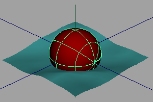

With a single command, you can add a NURBS sphere (a buoy) to your ocean and make it bob up and down in the water. The motion is restricted to the Y direction.
To add a dynamic buoy
