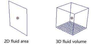

Use this procedure to add a fluid emitter to an existing fluid container. The emitter is automatically parented to the container so they move together when you move the container.
You can add multiple emitters to a container.
To add a fluid emitter to a container
Maya creates a fluid emitter at the center of the fluid container and parents it to the container.
