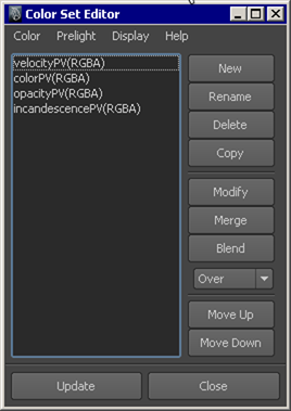

The Color Set Editor appears listing the per-vertex data generated from your nParticle object.
For example, if you want to color the nParticle output mesh using the per-vertex data derived from the nParticle object’s per-particle Incandescence ramp, select incandescencePV(RGB).
If your nParticle object’s per-vertex data does not appear in the Color Set Editor, click Update.

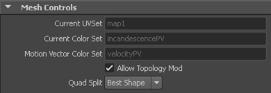

Your nParticle output mesh should now display the colors defined by the selected color set. In the Mesh Control section, the Current Color Set attribute should be set the selected per-vertex data set.
