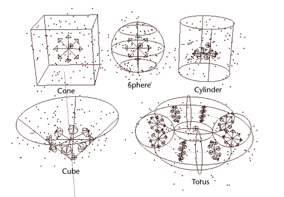

Volume emitters emit nParticles from a closed volume. You can choose from cube, sphere, cylinder, cone, and torus.
The implicit shape of the volume emitter is displayed on the screen. You can move, rotate, scale, or shear the emitter.
To hide the shape of the volume emitter
