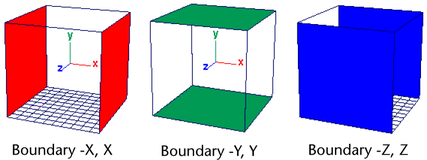

The boundary attributes control the way the solver treats property values at the boundaries of the fluid container.
For each boundary select one of the following boundary definitions:
Makes all boundaries of the fluid container open so that fluid behaves as though the boundary isn’t there.
Closes both boundaries of the fluid container so they act like walls.
Closes the -X, -Y, or -Z boundary, respectively, so it acts like a wall.
Closes the X, Y, or Z boundary, respectively, so it acts like a wall.
Causes the fluid flowing off one side of the fluid container to enter at the opposite side. This can be useful if you want to have a windy fog, but you do not want to continually replenish the Density at the in-flowing regions.
The fluid does not actually leave the container where there are no boundaries. It just appears to. Fluid can only exist inside a container.
