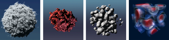

The following example of a 3D fluid in shaded display mode shows Density defined as a Y gradient. The effect looks like ground fog, with Density values gradually getting smaller along the Y axis. By applying a texture to it, you can give it a more realistic look. By animating (keyframing) the texture, you can make the fog appear to move without using dynamics.
You can also produce some interesting effects by applying textures to gradients and then animating the textures. See Texturing fluids.

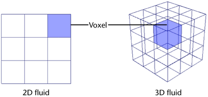

When you define a fluid property as a grid, you can place different property values in each individual grid unit called a voxel (volume pixel). Grids give you precise control over what the values are in the container. There are two types of grids: dynamic and static.

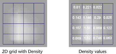

The following example of a 2D fluid shows Density in a grid. The image on the left shows the image in shaded display mode. The image on the right shows what the actual Density values are in each voxel.
