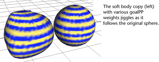

Makes a copy of the object a soft body without altering the original object. If you use this option, you can turn on Make Non-Soft a Goal (described later) to make the original object a goal object for the soft body. The soft body follows the animated goal object. You can edit the goal weight of the soft body particles to create rubbery or jiggling motion.
For instance, suppose you make a sphere a soft body with Duplicate, Make Copy Soft and Make Non-Soft a Goal selected. Next, you set keys to animate the motion of the goal object, which is the original sphere. You then give the particles of the soft body copy various goalPP values. When you play the animation, the soft body copy deforms like jiggling gelatin as it follows the original sphere. Note that you’ll typically hide the original sphere by turning on Hide Non-Soft Object.
