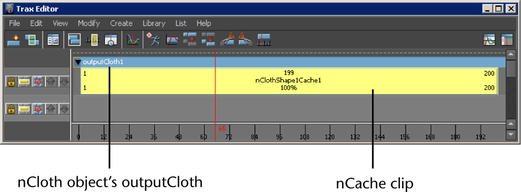

In the Trax Editor, nCache nodes are represented by nCache clips. With these cache clips, you can clearly view the relationships between your nCaches and edit your cached simulations in a nonlinear manner. This allows you to visually manage, manipulate, and direct all your objects’ caches at the same time.
To view nCache clips

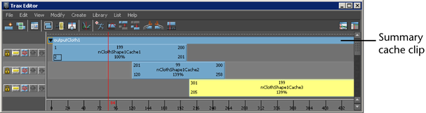

All the selected object’s cache nodes are loaded into the Trax Editor as cache clips. Each clip is placed on its own track, and all your object’s cache clips are grouped under your object’s cache label: outputCloth for nCloth caches, nParticleShape for nParticle caches, and fluidShape for fluid caches.

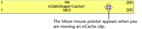

To move nCache clips
All the current object’s caches appear as clips in the track view.
To move multiple nCache clips in time

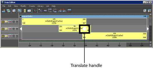

The translate handle appears.
The selected cache clips move forward or backward in time, changing their Start Frame values.
