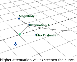

In some instances, the line that represents an attribute is a relative value. For example, if you drag a Magnitude value over 10, the line snaps to a fixed position. This occurs so that you can drag the value as high as desired without losing sight of the manipulator in the workspace. Some lines and curves represent actual measurements, for example, Max Distance and Attenuation.
Attenuation is represented by a curve that shows how quickly the field’s strength falls off from the field’s position to the end of Max Distance. If Max Distance is infinite, the curve is drawn 100 units long.

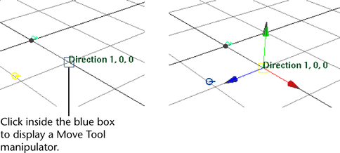

Click inside the blue box to display a manipulator that’s the same as the Move tool. Drag the center to move in all directions, or drag one of the arrows to move with directional constraint.

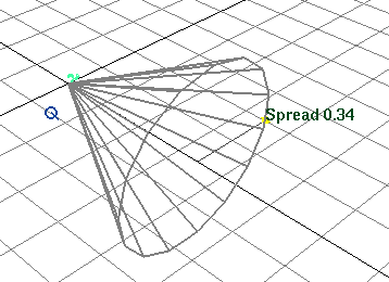

Drag the dot icon in various directions until you see a cone that indicates the Spread angle. When you begin to drag the dot, a line appears in the workspace indicating the direction you can drag.
