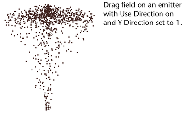

Specifies that the braking force is exerted only against the object’s velocity that lies along Direction X, Y, Z. Available in the Attribute Editor only.
For example, if you turn on Use Direction and your object is moving in the same direction as the drag force, the full braking force of the drag field is applied to it. If the object is moving perpendicular to the drag force, no braking force is applied. If the object is moving in the opposite direction, it speeds up.
Sets the direction of the drag force’s influence along the X, Y, and Z axes. You must turn on Use Direction for Direction X, Y, and Z to take effect.
