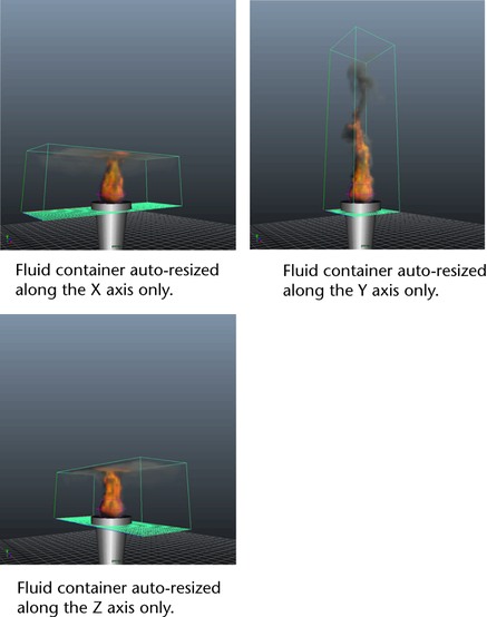

If Resize Closed Boundaries is off, any boundaries that are closed will remain fixed, as defined by the Container PropertiesBoundary X, Boundary Y, and Boundary Z attributes. This means that, when Resize Closed Boundaries is off, you use the Boundary X, Y, and Z attributes to specify along which axis you want the container to resize. By default, these attributes are set to Both Sides.
Even if Resize Closed Boundaries is on, setting the Boundary X, Y, and Z attributes to None allows the resize bounds to expand faster than if they are set to a closed setting.
For example, if you want the fluid container to resize only along the Y axis, with the X and Z axis not resizing, do the following:

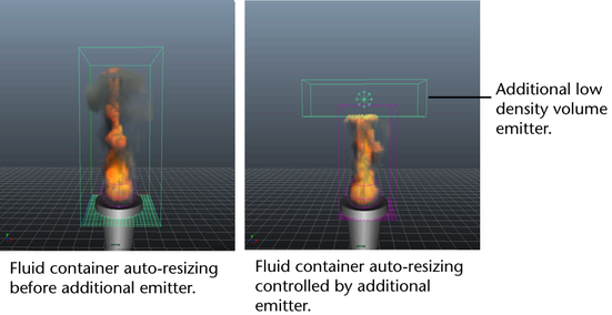

You can control how much a fluid container resizes by adding a low density volume emitter to the fluid container. If you set the density Emission Method of the new volume emitter to Replace, it replaces this portion of the contents with a very low density each frame. Since the replaced density is lower that the Auto Resize Threshold value, the fluid does not expand on the boundary adjacent to that region.
An advantage to this method is that the boundary created by the low density emitter is open, allowing the fluid to flow through.
Add a low density volume emitter by doing the following:
You can also use a low negative Density/Voxel/Sec value.
When you play the simulation the fluid does not expand into the volume defined by the second emitter.
