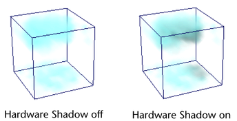

Turn this option on to self-shadow the fluid (the fluid casts shadows on itself) during the simulation (hardware draw). Shading > Hardware Texturing must be turned on to see this effect.
