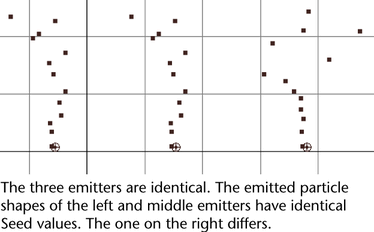

If you create two emitters with identical attributes, the random positioning of the emitted particles is identical, by default. You can cause each emitter to emit particles in different random positions by giving each emitted particle object a different value for its General Seed attribute. (see nParticle Lifespan attributes.
If a single emitter emits into several nParticle objects that have different Seed values, the emission positioning differs for each. If they all have the same Seed value, the positioning is the same.
The default value for each Seed entry is the same (1), so if you want two identical emitters to emit to different positions, you must set one of the Seed values to a different number. A new Seed value takes effect only after you rewind. When you change the Seed used by one emitted object, you won’t alter any other emission in the scene.
The size of a Seed value has no significance. For instance, a Seed value of 2 doesn’t create twice as much randomness as a Seed value of 1. Each number, for example, 1, 17, or 1000, simply sets a different sequence of random numbers.
If you use several emitters to emit into a single nParticle object, there a slider control for seed for each emitter.
