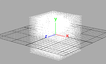

To create a 2D grid of particles by clicking in the workspace
This sets the spacing (in units) between particles in the grid.
To create a 3D grid of particles by clicking in the workspace
To create a 2D or 3D grid by entering values
