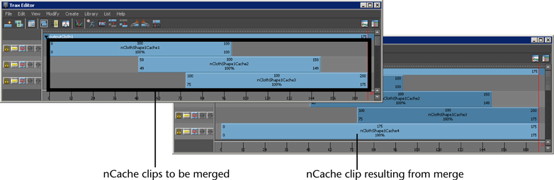

You can only merge nCache clips if each of the cache clips that are located in the merge time range are selected or disabled. For example, if you have cache clip 1 (frames 1-100), cache clip 2 (frames 50-150), and cache clip 3 (frames 100-200), and you want to merge cache clips 2 and 3, then cache clip 1 must be disabled or selected for the merge.
You can merge all your object’s cache clips at the same time by selecting the object, rather than its nCache clips, for the merge operation. On merge, all your object’s enabled cache clips are then baked to a single cache clip.
However, if any of your cache clips overlap, or if there are gaps between any of your clips, see Merge multiple non-overlapping nCache clips and Merge multiple overlapping nCache clips below.

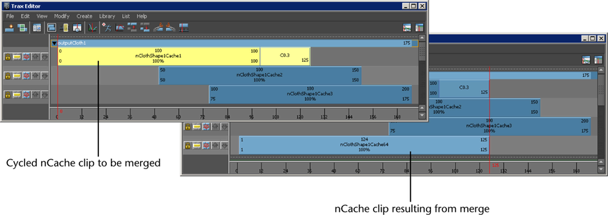

To merge a single nCache clip
You can merge individual scaled, cycled, or held nCache clips.
All the current objects’s caches appear as clips in the track view.
The single cache clip you selected merges according to the settings in the Merge nCaches Options window, creating a new ncache clip, cache file, and description file.
The nCache clip you merged is disabled and its associated cache file on disk is not overridden or deleted.

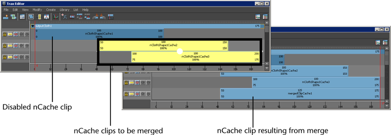

You can merge non-overlapping nCache clips.

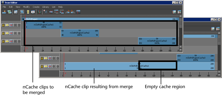

However, if there are gaps between the non-overlapping nCache clips you want to merge, then the gaps are linearly interpolated and no cache data for those gaps is saved to the merged cache clip.
For example, you have three cache clips that you want to merge: cache clip 1 (frames 1-50), cache clip 2 (frames 50-100), and cache clip 3 (frames 150-200). When you merge these cache clips, the length of the resulting merged cache clip will be frames 1-200, but frames 101-149 will contain no cache data.
To merge multiple non-overlapping nCache clips
All the current object’s caches appear as clips in the track view.
All selected non-overlapping nCaches merge according to the settings in the Merge Cache Clip Options window, creating a new nCache clip, cache file, and description file. See Trax Editor Edit menu.
The nCache clips you merged are disabled and their associated cache files on disk are not overridden or deleted.

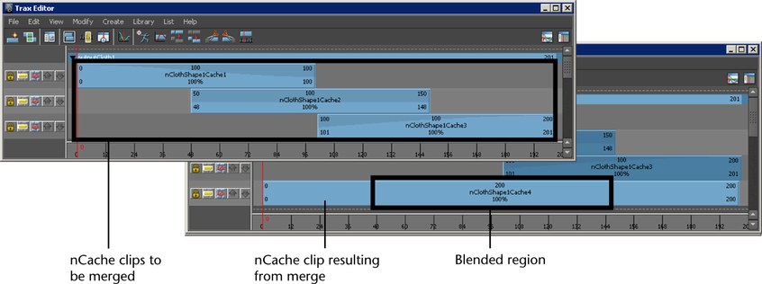

You can merge multiple overlapping nCache clips. The regions of the cache clips that overlap are blended according to their current Input Weight settings and any of their weight maps.
See Blend nCaches and cacheBlend node.
To merge multiple overlapping nCache clips
All the selected overlapping cache clips merge according to the settings in the Merge Cache Clip Options window, creating a new nCache clip, cache file, and description file.
The nCaches you merged are disabled and their associated cache files on disk are not overridden or deleted.
