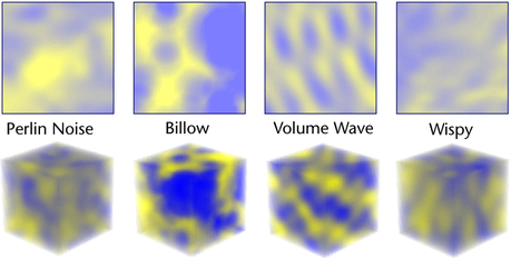

Select how to texture the Density in the container. The texture center is the center of the fluid.
The standard 3D noise used in the solidFractal texture.
Has a puffy, cloud-like effect. Billow is computationally intensive and therefore slow.
A sum of 3D waves in space.
A Perlin Noise that uses a second noise as a smear map. This makes the noise stretch out in places, creating a streaky, wispy effect.
A 4-dimensional version of Perlin Noise, where time is the 4th dimension.
