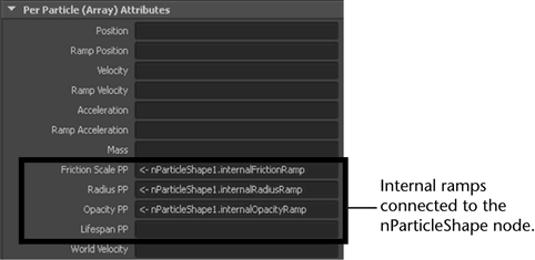

nParticle objects are created with internal ramps that are automatically connected to the appropriate per-particle attribute on the same nParticle node. Internal ramps let you control per-particle attributes are applied to your nParticle objects and are included in the nParticleShape node's Attribute Editor.
The connections between the nParticleShape node and the internal ramps occur on the same node rather than between different nodes. There are no external connections to ramp texture nodes. The connections are created when an input attribute is selected from the ramps in Scale Input list.

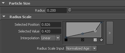

For example, on the Radius Scale ramp, when you select a Radius Scale Input, such as Normalized Age, the dynamic per-particle attribute is updated, and the input and output connections are made. nParticle Radius is now determined by the ramp's output and applied to particles on per-particle basis according to their normalized age.
If you select Off from the Radius Scale Input, the connections between the input and the output are broken, and if the output attribute is a dynamic attribute, it will be deleted. Be aware that the dynamic attribute is deleted even if it was originally created using the some other method, such as using Add Dynamic Attributes. You can view the Per Particle (Array) Attributes to verify which internal per particle ramps are currently being used by the selected nParticleShape node.

| Radius Scale | radiusPP | Set input to Age so that particles decrease in size as they age. See Radius Scale. |
