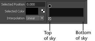

The Environment ramp defines a simple sky to ground environmental reflection on a surface. The left of the ramp represents the top of the sky and the right represents the bottom.
You define the reflection colors between the top and bottom of the sky by adding position markers to the ramp and changing the color at the markers. See Set fluid attribute ramps.
This value indicates the position of the selected color on the ramp (between 0 on the left to 1 on the right).
Indicates the color on the ramp at the selected position. To change the color, click the Selected Color box and select a new color from Color Chooser.
Controls the way colors blend between positions on the ramp. The default setting is Linear.
There is no interpolation between colors. Each color is distinct.
The values are interpolated with a linear curve in RGB color space.
The values are interpolated along a bell curve so that each color on the ramp dominates the region around it, then blends quickly to the next color.
The values are interpolated with a spline curve, taking the colors at neighboring position markers into account for a smoother transition.
