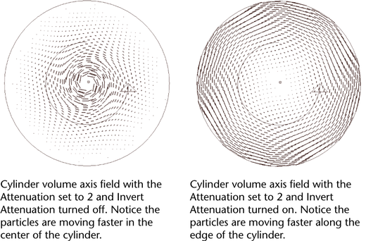

Sets how much the strength of the field diminishes from the central axis of the volume axis field.
If you set Attenuation to 1, the strength of the field diminishes in a linear manner from full strength at the central axis to zero strength at the edge of the volume axis field. Values greater than 1 make the strength of the field diminish to zero in an exponential manner—the greater the value, the more rapidly the strength decreases.
A value of 0 makes the strength remain constant from the central axis of the volume axis field to its edge (see also Invert Attenuation).

When you turn on Invert Attenuation and you have Attenuation set to a value greater than 0, the strength of the volume axis field is strongest at the edge of the volume and diminishes to 0 at the central axis of the volume axis field (see also Attenuation.

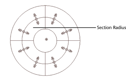

Creates a ramp which scales the Section Radius of a volume axis curve. The Curve Radius ramp is only applicable to volume field curves.
This value indicates the position of the Section Radius value. The left position on ramp represents the Section Radius at the base of the curve, while the right position on the curve represents the Section Radius at the tip of the curve.
This value indicates Section Radius value at the Selected Position.
