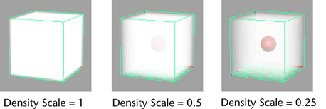

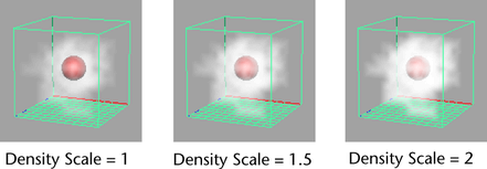

Multiplies the Density values in the fluid container (whether they are defined in grids, or defined by preset gradients) by the scale value. Using a Density Scale of less than 1 makes the Density appear more transparent. Using a Density Scale greater than 1 makes the Density appear more opaque.
In the following example, Density is set to Constant, which means it has a value of 1 throughout the fluid container. As you scale the Density values with a Density Scale less than 1, notice that the Density becomes less opaque and you can see the red ball contained in the fluid.
In the next example, Density is set to Dynamic Grid and the Density values are less than 1. As you scale the Density values with a Density Scale value greater than 1, notice that the Density becomes more opaque and the red ball contained in the fluid becomes more and more obscured by it.

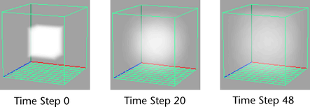

Defines the rate at which the Density gradually vanishes in a grid. At each time step Density is removed from each voxel (the Density value becomes smaller). In the following example, the Dissipation value is set to 1.
Dissipation in Fluid Effects is not the same as Lifespan with particles. Lifespan describes an on/off state (you are either alive or dead). Dissipation is a gradual fading out—it’s not absolute. The effective lifespan of Density in a grid is relative to the emission Density, motion within the grid, Diffusion, and the Transparency of the fluid.

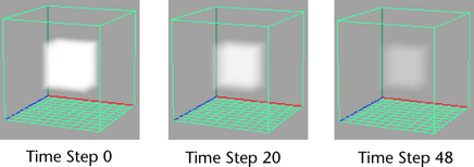

Defines the rate at which Density spreads into adjacent voxels in a Dynamic Grid. In the following example, the Diffusion value is set to 2.
