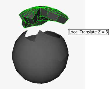

Once you’ve created a shatter with an extrusion, you can change the extrusion value for all the shards or for individual shards using the Local Translate Z attribute of the shard shape.
If you haven’t created the shatter using an extrusion, an extrusion node is not connected to the shards.
To change the extrusion value of a shard
