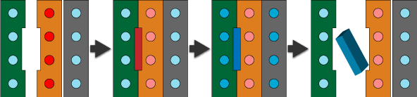

This category includes those techniques in which one or both sides of the mold is heated. Channels are drilled into the mold, which can be used for both heating and cooling, or dedicated to one or the other. For example, rapid heating could be achieved using electric heater cartridges located beneath the mold surface on the core side of the mold, as illustrated in the figure below.
Simplified illustration of the rapid mold heating/cooling process, using heater cartridges where the left-hand plate is the fixed plate, the center plate is the heating plate, the right-hand plate is the moving plate, the red circles are the heater cartridges and the blue circles are the cooling channels.
In the first image, the mold is open showing a small insulation gap between the heating plate and the moving plate. The heater cartridges are on and heating the mold. In the second image, the mold is closed, the heater cartridges are off, and the cavity is filled with hot polymer. In the third image, the cooling channels are filled with cold water and the part is being cooled. Finally, in the last image, there is no heating or cooling occuring, the mold is opened and the part is ejected.

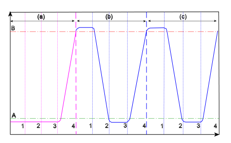

Schematic showing the simulated mold temperature changing during the rapid heating/cooling process where (a) is cycle 1; (b) is cycle 2; (c) is cycle 3; A is the ejection temperature; B is the polymer glass transition temperature; 4->1 is the injection/packing stage; 1->2 is the cooling stage; 2->3 is the mold open/ part ejection stage; and 3->4 is the heating stage.
Note: The simulated injection molding cycle starts with the injection step. Clearly, this means that for the mold rapid heat/cool simulation, the first cycle does not reflect mold heating accurately.
