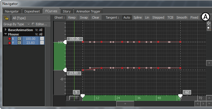

The FCurves pane displays function curves of selected properties and provides you controls for manipulating the curves. You can edit curves by moving tangent handles of a keyframe to change the shape of the curve. You can also choose different types of interpolation to either smooth the curve or sharpen angles.

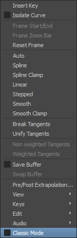

					  Isolate Curve  |
					  Displays only the selected function curves in the FCurves pane. You can also activate this option by selecting Isolate Curve from the context menu. See FCurves context menu.  |

FCurves pane in Classic Mode A. Options in the classic toolbar
