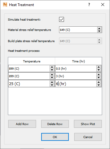

In Local Simulation, users can add a heat treatment cycle to the end of a thermo-mechanical simulation to relieve stresses accumulated during manufacturing. This tutorial uses the material Inconel 625.
Sample files for use with the tutorials are available from the Downloads page. Expand the downloaded ZIP archive into a convenient directory from which you can import files into Local Simulation as you need them.
The time value for a particular temperature phase indicates the elapsed time from the beginning of heat treatment to the end of that temperature phase. The system will check that the times are a series of increasing values.

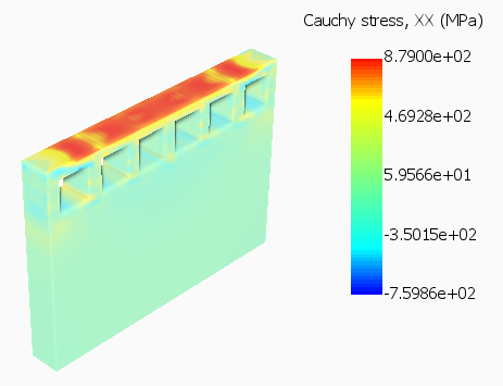

Maximum stress occurs in the first increment of heat treatment (shown below), then gradually relaxes.
