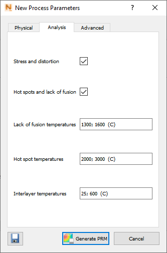

To examine the settings for lack of fusion and hot spot analysis
Note the icons in the library to differentiate the stress and distortion processing parameter (PRM) files
from the ones for lack of fusion, hot spot analysis, stress, and distortion
, as if to generate a new PRM file.
By means of the two check boxes at the top, you can specify the type of PRM file to create: for Stress and distortion analysis, Hot spots and lack of fusion analysis, or both. The three temperature fields at the bottom of this dialog are active only if you select Hot Spots and lack of fusion. The temperatures that should be set for this type of PRM generation are as follows:
Lack of fusion temperature - This specifies the temperature(s) below which the part will not fully fuse, typically the Liquidus temperature, Solidus temperature, or both. The reported result from this during part level thermal simulations is an indication of what percentage of each element is likely to fall below that temperature. For conservative models, use temperatures lower than the Solidus temperature of that material.
Hot spot temperatures - This specifies the temperature(s) which, if exceeded, can result in poor build quality. The results of the ensuing part level simulation depicts what percentage of each element is likely to be above each hot spot temperature.
Interlayer temperatures - The specifies which interlayer temperatures should be investigated during PRM generation. More temperatures create a finer level of prediction, but each additional temperature will add computational time.
Best practices - To determine what interlayer temperatures are necessary it is suggested that the part level geometry or geometries that are of interest for that combination of processing conditions are simulated first using a standard stress and distortion PRM and choosing the Thermal only analysis type on the Analysis tab of the Solver Settings dialog. Determine from the simulation(s) the peak temperatures that may be experienced. This should be used for the upper interlayer temperatures, rounded up to the next 100° C. The lowest temperature should be set to the ambient temperature, typically 25º C. To determine what other temperatures should be used, plot the thermal properties of the material in question with respect to temperature. Add additional interlayer temperatures where observable non-linearities occur.

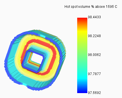

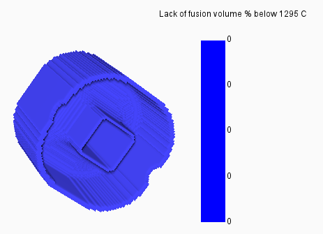

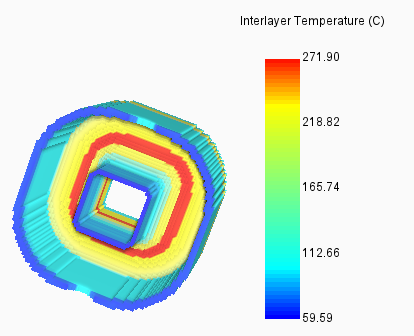

Several results are temperature-related:
Hot spots are most likely to appear in the thickest part of the build material, and that is the case here.
You can see that this simulation predicts no lack of fusion in the build, below 1295° C.
