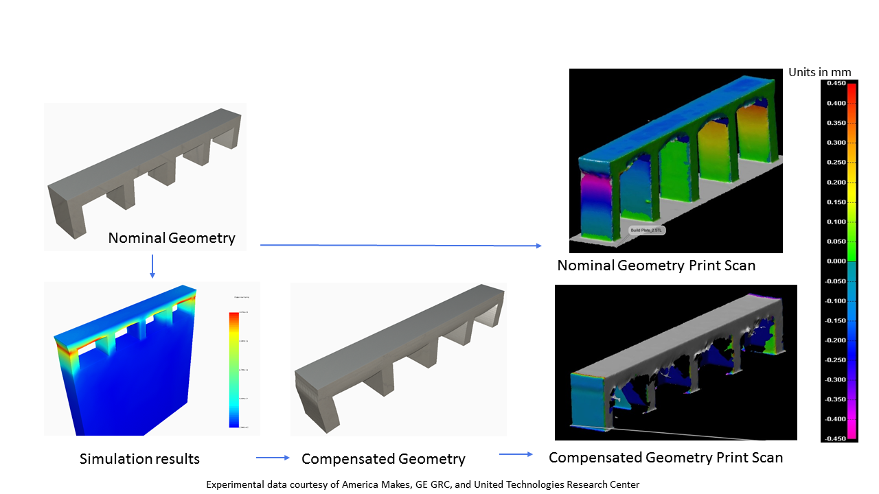

Warped STL feature to modify the geometry of an STL file to compensate for the distortion that was revealed in a simulation of the original geometry. The figure below illustrates this concept:![]()
When the nominal geometry is printed, it shows excessive distortion. The same distortion is predicted by the model. Using compensation, the original geometry is altered based upon the predicted displacements, which when printed, shows a significant reduction in distortion.

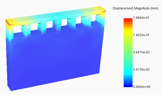

Original displacement results

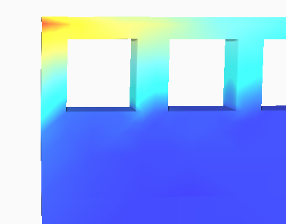

The figure shows simulation results using the file Example_12.stl. Note the areas of maximum displacement at the upper, outer corners of the original part. A closer look shows that these outer corners are displaced slightly inward, toward the center of the part.
When we prepare a compensated STL, we can expect to see the geometry offset in these corners so that displacement during the build will modify the geometry into the desired final shape.

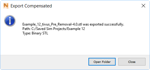

The Export Compensated dialog shows you the name of the warped STL file, which contains the warpage magnification factor in an extension of -4.0.stl, and the path to the file.
The file name also includes the string _Pre_Removal if you used the Increment setting All parts on build plate, or the string Post_Plate_Removal if you used the setting After removal from build plate.

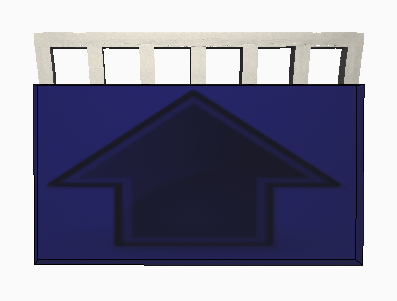

You should notice that the upper corners are pushed outward to compensate for the expected inward displacement. The warpage magnification factor of -4 was intended to show displacement that is clearly visible, but this value is too extreme to use in practice.
