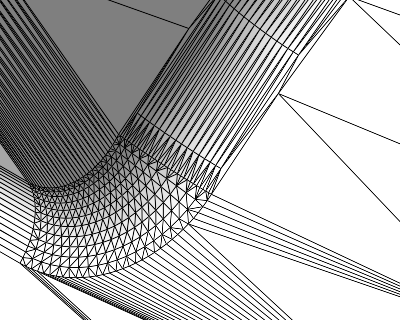

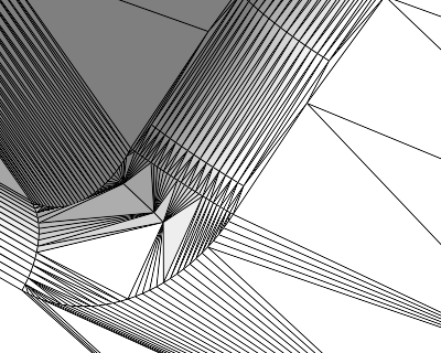

Tip: If you have two rounded bevel edges meet at a corner, setting this to a smaller value will ensure that the corner is properly rounded, too.
Millimeters 0.05-20 mm
This is the same location of several beveled edges meeting, one with 1 mm, the other with 0.05 mm maximum surface deviation.

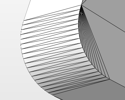

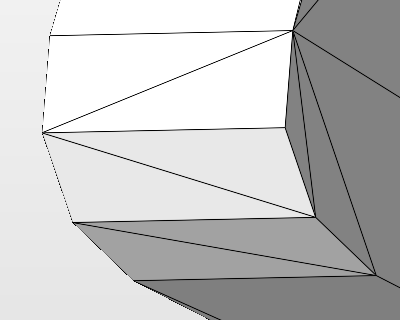

This parameter specifies the maximum change in the surface normal between adjacent nodes in the mesh. This applies along the EDGES and between the grid lines.
Effectively, the lower this number, the finer the resolution of imported curves and roundings.
Degrees 0.1-40°
This is the same corner, one with 40 °, the other with 5 ° angle tolerance, imported with an otherwise rather high maximum surface deviation.
