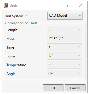

  5. Go to Tools > Document Settings > Units. Set the units to inch and lbmass (pound). They will become the Default units.
  6. Or, double-click Units in the tree and select a Unit System with units set to inch and lbmass (pound).
  7. Click OK.
