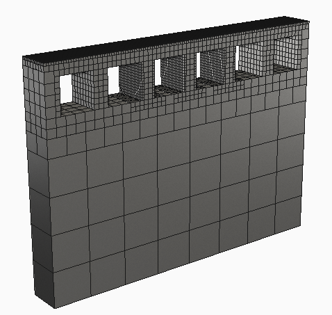

A generic geometry of Inconel 625 is built in a powder bed system and simulated. The layer height is 0.04 mm. The part geometry is imported in the analysis through an STL file, and it is automatically meshed within Local Simulation. The substrate is assumed to be 24 mm thick. The actual build plate is planned to have 5 similar geometries on it. Here, a simplified analysis is performed on just 1 of the geometries. The *PBDL card is used to add the deposition multiplier for the geometries that are not included in the analysis. The *PBIS card insulates the side of the small substrate in the analysis, simulating the effect of having other builds on the build plate nearby.
The *PBSS card constrains the sides of the small substrate in the analysis, mimicking the effect of being attached to the larger build plate. The build plate has an initial temperature of 100o C, which is modeled using *INIT. The resulting mesh is illustrated in Figure 1.
Figure 1: Auto-generated finite element mesh
