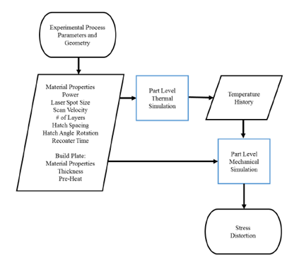

In order to run Part-Level Powder-Bed analysis in Local Simulation, a process parameter (PRM) file must first be generated. The PRM file links the small scale moving-source analysis to the full part-level analysis. This is illustrated in Figure 1 below.
To create accurate PRM files, which will result in accurate part scale models, PRM generation must be performed using the prm_gen program. Merely running the small scale simulations without using prm_gen will leave out key portions of the PRM generation process which will produce an inaccurate PRM file.
Figure 1: Relationship between the fine scale and part-level analyses

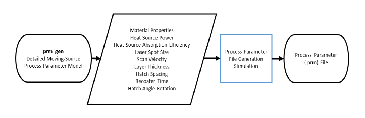

Here, a process parameter file is generated for Inconel® 625 using the following set of parameters:
The parameters are entered into the *LSRP card. The *GTAB card is used to output and name the process parameter file. The flow of the analysis is shown in Figure 2.
Figure 2: Flowchart for generating PRM files

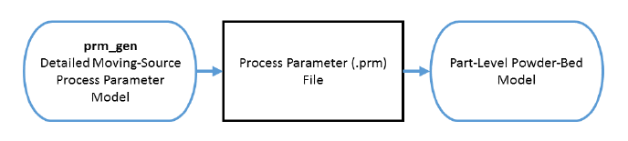

A time incremental thermal analysis is performed first to compute the temperature history of the part followed by a time incremental mechanical analysis. The PRM file is filled out for several different section thicknesses and temperatures. The thickness of a section is controlled by using the 10th input of the *LSRP card and the temperature is controlled by using the *INIT card. Once the full table is filled out in the PRM file, the file can be input along with geometric information for the Part-Level analysis as illustrated in Figure 3. Part-Level analyses are demonstrated in later examples in this help system.
Figure 3: Flowchart from fine-scale to part-scale thermo-mechanical simulations
