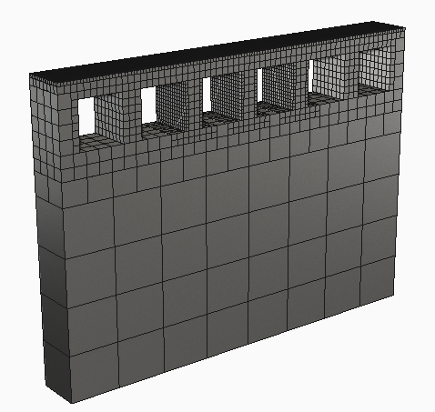

A generic geometry of Inconel 625 is built in a powder bed system and simulated. The layer height is 0.04 mm. The part geometry is imported in the analysis through an STL file, and it is automatically meshed by the Local Simulation solver. The substrate is assumed to be 38.1 mm thick. The resulting mesh is illustrated in Figure 1.
Figure 1: Autogenerated finite-element mesh
