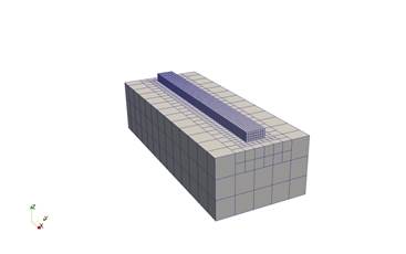

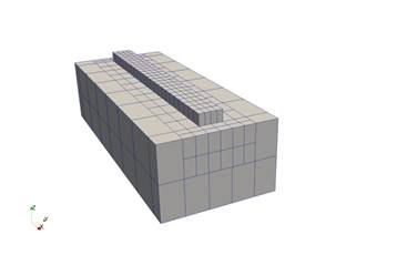

The following figures illustrate the effect of *NELR card upon the auto-generated mesh. Note that the change in elements per laser radius will scale up the total number of elements in the model. It is recommended to increase the *ADAP value to inhibit extraneous element production.
(a) NELR = 2, *ADAP = 2
(b) NELR = 4, *ADAP = 2
(c) NELR = 4, *ADAP = 3
