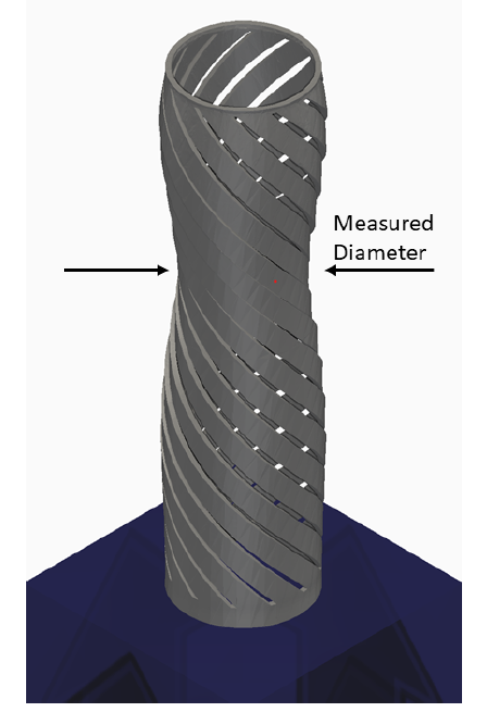

The first step of the calibration process is to manufacture the test part using the material and processing conditions for which a PRM file is desired. Then the peak distortion needs to be measured. This can be achieved using basic metrology equipment such as calipers or a micrometer.
To perform the measurement, use the calipers to determine the diameter at the ’waist’ of the cylinder where the peak displacement occurs. Subtract from the manufactured diameter the nominal width of the test part (12.7mm) and divide by 2 to get the distortion of the printed part:
Measured Distortion = (Measured Diameter – Nominal Diameter)/2
Experimental model and measurement location
For this example, assume the manufactured part is 12.06 mm at the narrowest point:
Measured Distortion = (12.06 mm - 12.7 mm)/2 = –0.32 mm
