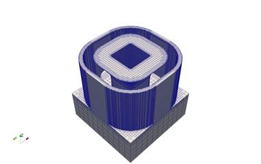

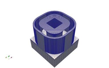

The activation thickness is equal to n · t · 2i1, where n is the number of layers per group and t is the powder layer thickness (i2 and r1 values in *PBPA card). The effect of the *PBLR card is illustrated in the figures below, where in Figure a  it is shown that the added group of elements is composed of fine elements without the *PBLR card. The adaptive coarsening allowed by *PBLR is shown in Figures b and c. Note that single core run times can be quartered between the No *PBLR and *PBLR = 2 simulations, however this coarsening will reduce the accuracy of the simulation.

(a) No *PBLR, *PBPA = 5, Run time = 13965 s
(b) *PBLR = 1,*PBPA = 5, Run time = 6462 s
(c) *PBLR = 2,*PBPA = 5, Run time = 3213 s
