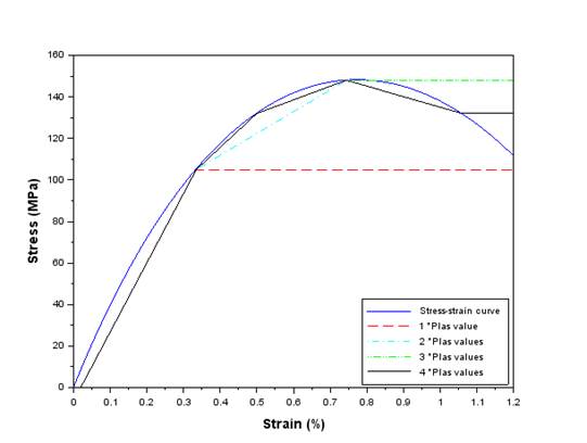

The following graph shows an example of fitting a stress-strain curve using the *PLAS card using 1-4 values. Using just 1 value assumes perfectly plastic behavior. Using 2 points along the stress strain curve will create a bilinear map of plastic properties, one line between the yield point and the second point, and then a region of perfect plasticity extending from the second point. This is the most common method to model the plastic behavior, and has been shown to be effective for various metals. Additional points may be used to further describe the stress-strain curve as desired by the end user. The more detailed the stress-strain behavior is defined in the mechanical model, the slower the convergence will be each step.
Approximating the stress-strain curve using 1-4 values in the *PLAS card
