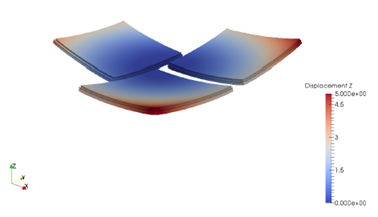

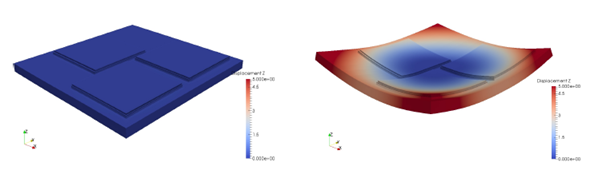

Figure 2 shows the computed final distortion at three times: before the build plate is removed from the machine, after the build plate is removed from the machine, and after the part is removed from the build plate. Distortion is in mm with 5X magnification.
Figure 2: (a) After deposition and before build plate removal from the machine, and (b) After build plate removal from the machine
(c) After part removal from the build plate
