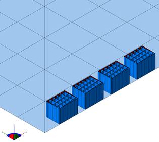

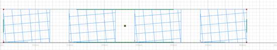

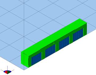

The following figures show examples of compatible box type supports, and an example layer slice of the supports. These can be easily generated using Netfabb® with the provided automated support script box_type_no_fragments.support.
Box type supports on STL
Box type supports
Box type layer slice
