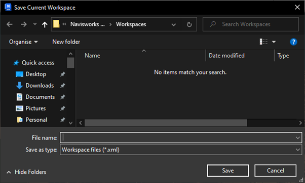

Click View tab > Workspace panel > Save Workspace
In the Save Current Workspace dialog box, enter a name for the new workspace. You can also select the name of an existing workspace to overwrite it with your modified configuration.
Click Save.
